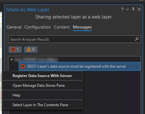

I have a PostgreSQL database instance running in the Azure Database for PostgreSQL service. I am able to successfully connect, create enterprise geodatabases within, and load feature classes. I am also able to register the database as a data store, both via ArcGIS Pro and ArcGIS Server Manager. However, when attempting to share a table in the database as a web layer (right click > Sharing > Share as web layer), it will ultimately fail with error 00231, "Layer's data source must be registered with the server." seemingly not recognizing the registered data store I had just added. I verified there were no typos or other configuration errors.

  • Run "Analyze" and right click error 00231 > Register Data Source with Server

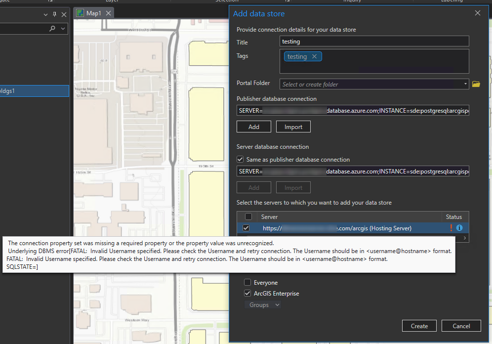

I observed something interesting at this point; the connection string automatically generated in the dialog box truncates the "@hostname" part of the username, and the validation will fail:
HfVeYVx
I am able to click "Import" in this dialog box and manually specify the .sde connection file, the generated connection string does not malform the username, and the data store can be registered. However, I am right back to the same issue and receive error 00231 once again when attempting to run "Share as Web Layer."
