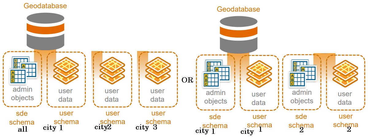

I want to separate data into schema based on their administrative location (city). For example: Schema 1 will hold data for City 1, Schema 2 will hold data for City 2.
I am using postgresql 13.
I am thinking of these options but can't decide the pros and cons:
PS: i don't know if the second picture is possible
thanks

I think that option 1 is possible and people do this already. You just have a different user (schema) & tablespace for the cities. This would cause you to have more overhead management with multiple data owners and some of the tasks that go along with that but may be easier in other areas.
Option 2 is not possible, that looks like the old multi-user schema GDB's that we deprecated in Oracle.

In your scenario, I would create a separate geodatabase for each city data, to keep the data separate, to improve performance, and to enhance security.
