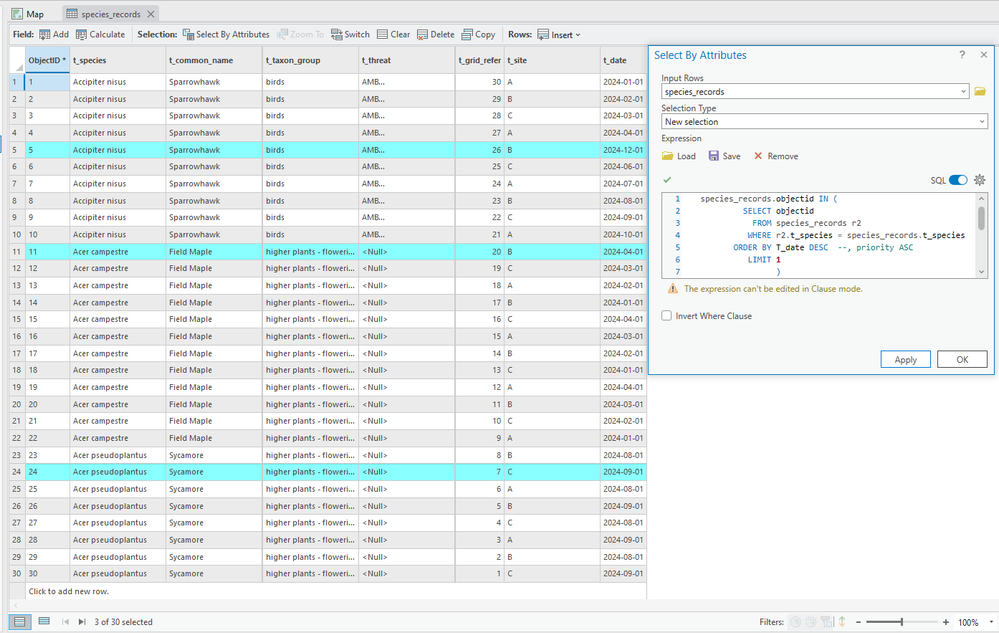

Here's a mobile geodatabase technique for #2 - no ties.
species_records.objectid IN (
         SELECT objectid
           FROM species_records r2
          WHERE r2.t_species = species_records.t_species
       ORDER BY T_date DESC  --, priority ASC
          LIMIT 1

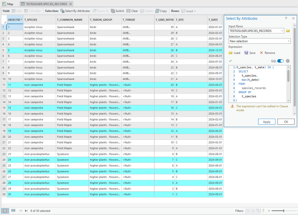

Since SQLite supports a row value on the left-hand side of the IN operator, an alternative to n=1 that doesn't require a correlated subquery is:
(t_species, t_date) IN (
  SELECT
    t_species,
    max(t_date)
  FROM
    species_records
  GROUP BY
    t_species

Mobile Geodatabase/SQLite:
For my notes, I'm confirming that the approach works in a mobile geodatabase. Greatest 1 per group (with ties), as expected.

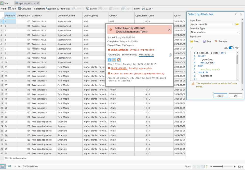

File Geodatabase:
Unsurprisingly, it doesn't work in file geodatabases.
SQL Server:
I couldn't get it to work in SQL Server: https://dbfiddle.uk/dtiYKrf_

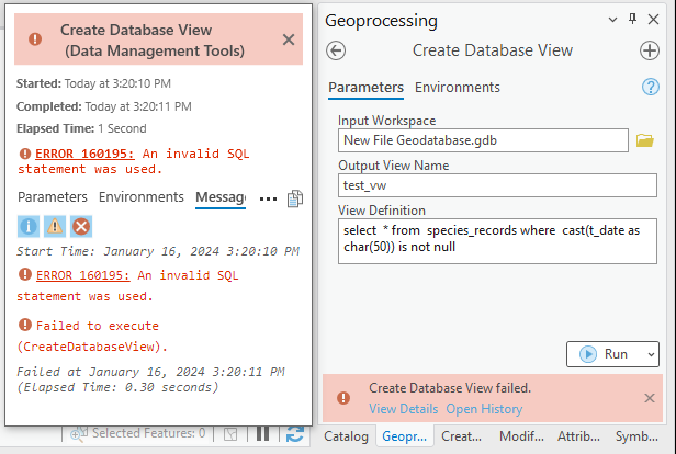

I couldn't even get CAST() to work on its own in the WHERE clause in a simple view.
select
from
    species_records
where
    cast(t_date as char(50)) is not null
ERROR 160195: An invalid SQL statement was used.
But that query works fine in Oracle and in a mobile geodatabase.
I'll report it to support as a FGDB bug.

JoshuaBixby
MVP Esteemed Contributor
Regarding not being able to create a database view with CAST in the WHERE clause, that is interesting because CAST works in the Select By Attributes tool, which of course is the WHERE clause:
CAST(t_date AS CHAR(20)) IS NOT NULL
