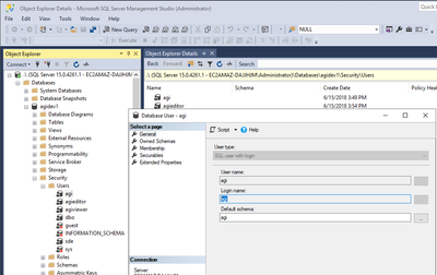

JD1016
Okay.  For step 1...some clarification...since I did not create this database...
Hopefully this is the correct location I should be looking...I believe these are the "user names" but I'm not sure where to locate the "login names"?
Please see screenshot...
Thanks.
MarceloMarques
see example below
