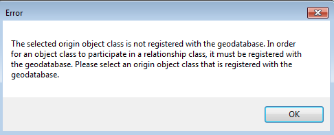

I was trying to create a relation class between a feature and table in my database when abruptly this thing popped-up.
I am new to database management in arcgis. What should i do? Thank youu!

When creating a relationship class, ensure the participating feature class and table are stored in the same geodatabase.

Hey Mr Poddar,
The destined table is located in the exact same geodatabase with the feature class. Thats why i am confused about that warning.

Try Registering a table with the geodatabase before you proceed.

Relationship Class is a geodatabase functionality and so you cannot use a Database table (Table created from the database end and not registered with the geodatabase) in it.
As Jayanta suggested, register that Table with the geodatabase (Connect as Data Owner> R-click on the Table> Manage> Register with Geodatabase) and then check.
