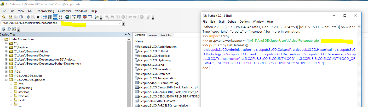

I don't have pyscripter but I can run this in an idle shell:
That should just about do it....

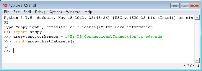

Here how it happens even when I try the same in IDLE

I wonder if it's bombing on the spaces in your actual paths.
