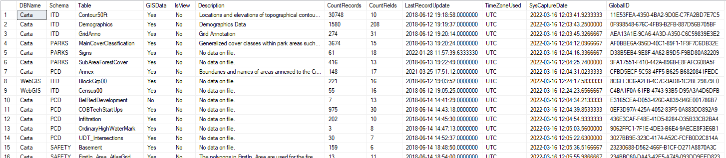

In case anyone else has a use case like I did, here is a script that will lift, out of your database essential information about your datasets to include when they were last updated, some metadata to give you a general idea what it is, all the fields and their configurations, row counts, etc.
https://github.com/AlkalineCandy79/GeoDatabase-Meta-Extraction
