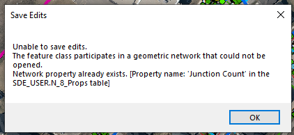

Today the error also appeared for users editing the data and attempting to save their edits.
Error dialog when attempting to save edits to a feature class that participates in a geometric network.
I’m hoping to get to the bottom of this and resolve the issue and restore my confidence in the integrity of our database.
