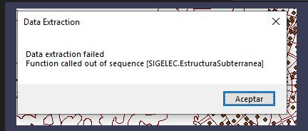

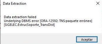

When trying to extract data from a geodatabase to another geodatabase I am gettin the error from the images    and
Please if anyone can help. I am doing it from ArcMap 10.6.1, my geodatabases are in Oracle 11.2.0.4.

Based on the error messages from Oracle, it looks like there is no longer a connection open to the Oracle geodatabase.
ORA-03114: Not Connected to Oracle tips
I would recommned closing and re-opening the MXD or refreshing the data source and attempting again.

David_RonaldSuárez_Urresti
Hi George, I checked the connections with the dba. The user has no time out and the dba confirmed activity in the connection. I run the process twice in the weekend (thinking if there was a network problem) and now the error is:
Best regards

I would recommend that you open a technical support case with your local technical support office. Those first errors are related to Oracle and I am not sure about the last one.
