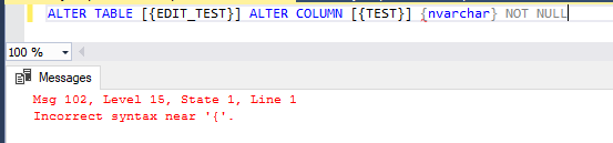

AlexP_
@VinceAngelo Thank you for the information. Please see screenshot. I got an incorrect.
Msg 102, Level 15, State 1, Line 1
Incorrect syntax near '{'.
VinceAngelo
Esri Esteemed Contributor
The "{tablename}" and "{columnname}" and "{datatype}" need to be replaced with actual values, e.g.,
ALTER TABLE [EDIT_TEST] ALTER COLUMN [TEST] nvarchar({actualwidth}) NOT NULL
(Yes, you need to replace "{actualwidth}" with the defined width of the column).
