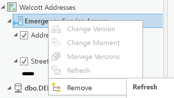

I have been using branch versioning for a while for my parcel fabric.  And now I wanted to use this sort of feature service for more of my data layers.  I have a SQL server database, and have successfully created a database connection, with a geodatabase connection type of "branch versioning."  And I have been able to actually edit using the feature service that I created.  My only problem is that I cannot seem to change from the default version and create any additional versions.  When I right click on the data tab to try to manage the versions, it is grayed out.  See below:

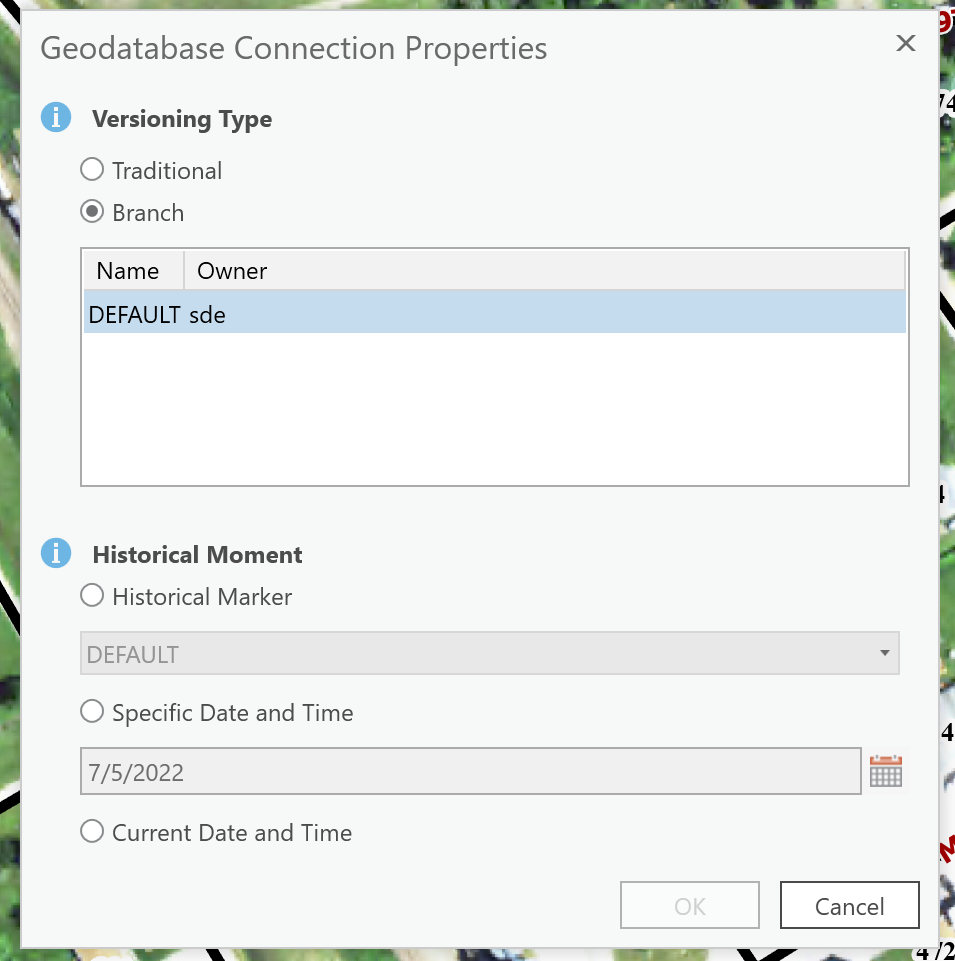

When I go to the connection properties, this is what I show:
I am not sure what I missed in the process of setting this up.  Any ideas?

Did you enable the Version Management Server (VMS) when you shared the service?

I did this same thing and determined I forgot to enable the VMS on the service.

I remember those settings when publishing my parcel fabric, but I couldn't find them when creating this service.  I just looked, and I still do not see them.  There must be a problem in the geodatabase??

It says versioned.  And the connection says versioned.  And it lets me edit, but does not allow me to create or change versions.  I am going to try copying the dataset to a database that is already working in branch and see if that works there...
