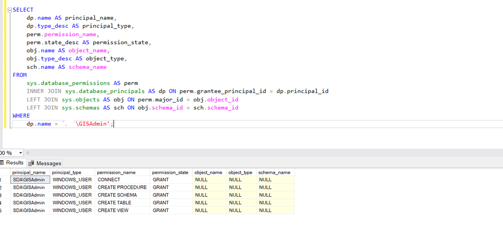

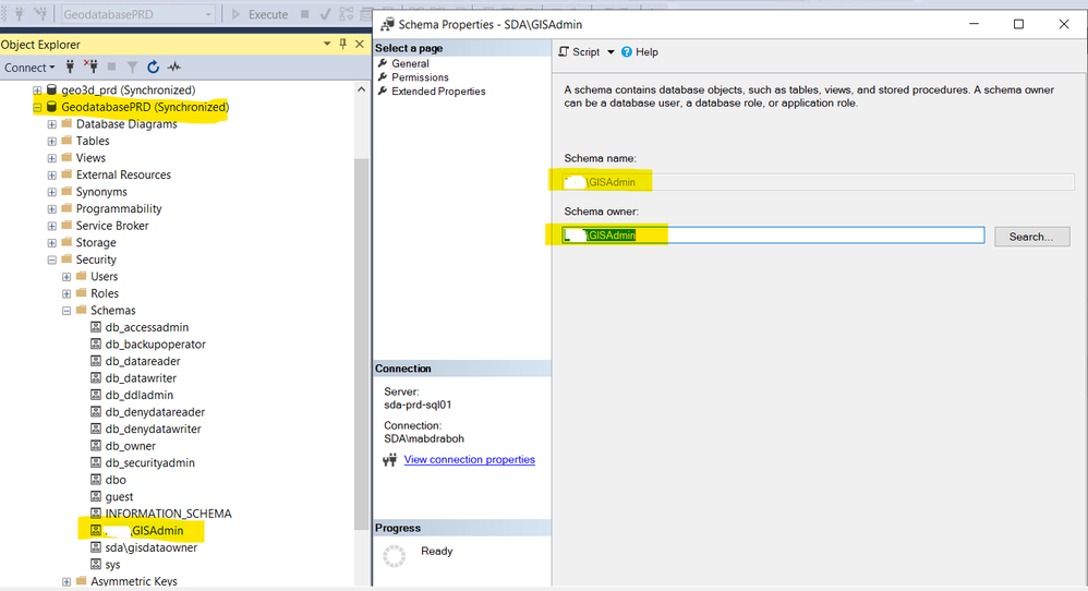

gisarchitect
@George_Thompson
  • Yes I'm logging with the data owner in my case the data owner name is 'GISAdmin'.
  • Attached is a screenshot with the permissions assigned
  • The username/schema mapping is correct. see the screenshot for the mapping.
I do appreciate your reply.

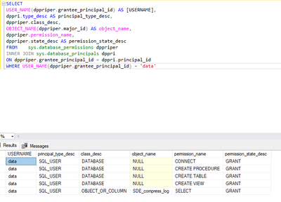

So, I ran a similar SQL for permissions and the difference I saw, was in the 'principal_type_desc' field. My data owner ("data") is a SQL_USER and not a WINDOWS_USER.
SELECT
USER_NAME(dppriper.grantee_principal_id) AS [USERNAME],
dppri.type_desc AS principal_type_desc,
dppriper.class_desc,
OBJECT_NAME(dppriper.major_id) AS object_name,
dppriper.permission_name,
dppriper.state_desc AS permission_state_desc
FROM    sys.database_permissions dppriper
INNER JOIN sys.database_principals dppri
ON dppriper.grantee_principal_id = dppri.principal_id
WHERE USER_NAME(dppriper.grantee_principal_id) = 'data'
Can you please see if your login properties match something like this for the GISAdmin user?
--- George T.

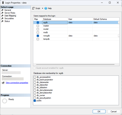

@George_Thompson  I have attached the loggin mapping screen. It seems the same as yours.
For the type of loggin (SQL User or Windows) Are there any differences or restrictions in case Windows login is used?
George_Thompson
Esri Notable Contributor
Not sure if there is a difference between the two......
I would highly recommend reaching out to technical support on this issue. Outside of the SQL vs Windows login, everything seems to be ok. I have also not seen that issue like this.
--- George T.
