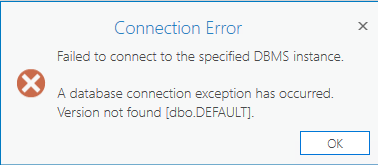

Running ArcGIS Pro 2.7.3 as the 'geodatabase administrator' account, using "Enable Enterprise Geodatabase" GP tool after creating SQL Server 2016 database per the instructions here:
...the GP tool finishes and reports success.
However, when I try to interact with the database connection, ArcGIS Pro tosses up:
Sometimes, but not always, I can run ArcGIS Pro as the 'data creator' account and paste a feature class into the database. After completing this step, I can close ArcGIS Pro running as 'geodatabase administrator' account, then start ArcGIS Pro as 'geodatabase administrator' account and everything appears to be working correctly. Sometimes I get stuck here.
Have any of you run into this, and do you have any ideas how to have a consistently pleasant and error free experience when enabling enterprise geodatabases?
