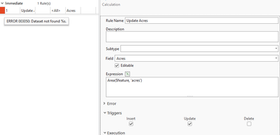

I am getting an error while saving calculation Attribute rule in ArcGIS Pro 3.2.1

This is not an error I would expect. Are you working with EGDB? Have you tried refreshing the DB connection, close/open pro? What is your data type for the acres column?
I just tried your expressions and it works for me.

Yes . I’m using EGDB SQL Server acres data type is double( 7,4 ). I did refresh database, connected as owner and reopened arcgis pro. Nothing is working ..

If dataset is locked , it would throw a different error “exclusive locks …… “ .

I have tested with Pro 3.2 with no issue using the same double (7,4) on SQL.
Are you able to create any attribute rule? what about another feature class?

I was able to do same in our development database. I don't know what exactly issue is

I tried with different feature class and this time, I did it for long data type. I am getting same error . is something issue with EGDB?
MarlonAmaya
Almost seems as your DB connection is unable to access the feature class. Are you able to view the FC properties via catalog? Create a new FC and add global ID's and see what happens.

I tried Creating a new  feature class and same error. I updated the geodabase to latest and nothing is working
