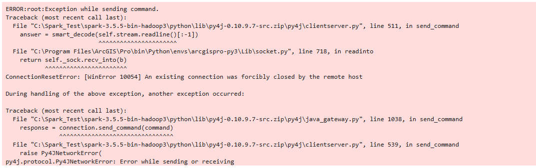

Hi all,
I have been working in GeoAnalytics Engine Local Mode configuration for a few months now.  Everything was working, and then one day I tried to run my code and this error started popping up.  I have tried everything - checking system variables, reinstalling Java, re-downloading dependency files, even re-writing the functions that were kicking off the error only for them to pop up farther down in the script for something similar with GeoAnalytics functions or Spark functions.
Has anyone seen an error like this before? My IT department updated the machine the day before this happened, is it possible that some of the ports got blocked and that is why the Java Virtual Machine is rejecting the request?  I tried manually assigning a listening port to the spark session, but that also did not work.
Thank you for any guidance!! I will attach the error below.
