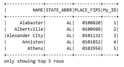

Next, we’ll read in a dataset of US major cities to use as our example data. In this case, we’re just going to use a few attributes from the original Living Atlas feature service.  For this example, we’re going to remove the OBJECTID field that is automatically generated in a Feature Service and replace it with a field called “My_ID.”  This is just used to show the creation of a unique indexed OBJECTID when we write our new feature service (otherwise we end up with a second OBJECTID field when we write it in the next step of our demonstration).
# read in a dataset to use as an example for upsert
# US major cities dataset from ArcGIS Living Atlas of the World
myFS="https://services.arcgis.com/P3ePLMYs2RVChkJx/arcgis/rest/services/USA_Major_Cities_/FeatureServer/0"
myFSDataFrame = spark.read.format('feature-service').load(myFS)\
    .select("OBJECTID", "NAME", "STATE_ABBR", "PLACE_FIPS")\
    .withColumn("My_ID", F.col("OBJECTID"))\
    .drop("OBJECTID") # drop the original OBJECTID field since we will be using My_ID as the upsert matching field instead
myFSDataFrame.show(5)

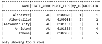

We can pull the data back down from this layer to confirm the contents are as expected, and then to identify a few rows that we will update using upsert. Note that we’re specifying the option to connect to our ArcGIS Online account. It is important to ensure that you have registered the ArcGIS Online account where your data lives so that you can access the data for reading and writing!
# read our data from the new feature service - we will use this DataFrame to demonstrate the upsert functionality
myNewFS = "https://your_service_URL"
myNewFSDataFrame = spark.read.format('feature-service')\
    .option("gis", "myGIS")\
    .load(myNewFS)
myNewFSDataFrame.show(5)
Our new feature service has all of our original fields, plus a new OBJECTID field that was automatically created when we write the feature service.

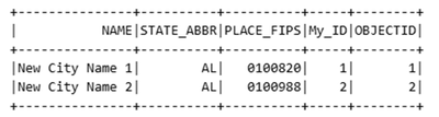

Now, we can check that the changes went through by reading our feature service back in and looking at the data:
myfs_upsert_url  = "https://your_service_URL"
myFSDataFrame_after_upsert = spark.read.format('feature-service')\
    .load(myfs_upsert_url)
myFSDataFrame_after_upsert.show(5)
And only two rows needed to be updated!  This will typically be more efficient than overwriting the whole table.
