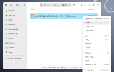

There will be two files – both are tar.gz files and you will need to extract the files from the *.tar.gz file. You may be able to simply right click on the downloaded file and select “Extract [to …]” to extract the GeoAnalytics Engine files.

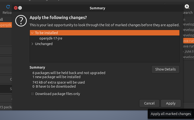

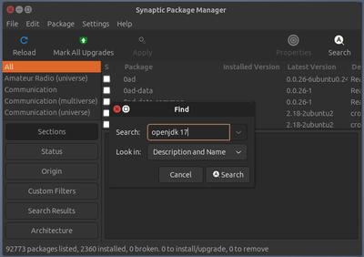

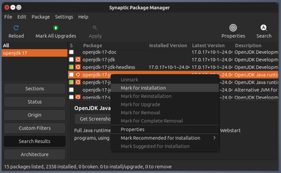

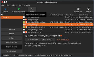

    OpenJDK is generally available from the package manager in a Linux distro, and can be installed via either a GUI such as Synaptic or a command such as:
sudo apt-get install openjdk-17-jre
The process will look something like this:
Search for openjdk 17Search for openjdk 17
Mark openjdk 17 for installationMark openjdk 17 for installation
Apply all marked changesApply all marked changes
Confirm applying changesConfirm applying changes

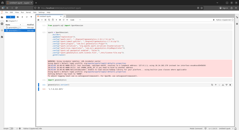

Then we can confirm that everything works by trying some simple code in a Jupyter notebook:
import geoanalytics
geoanalytics.version()
This output of GeoAnalytics Engine version of 1.7.0.213.3871 in the notebook.This output of GeoAnalytics Engine version of 1.7.0.213.3871 in the notebook.

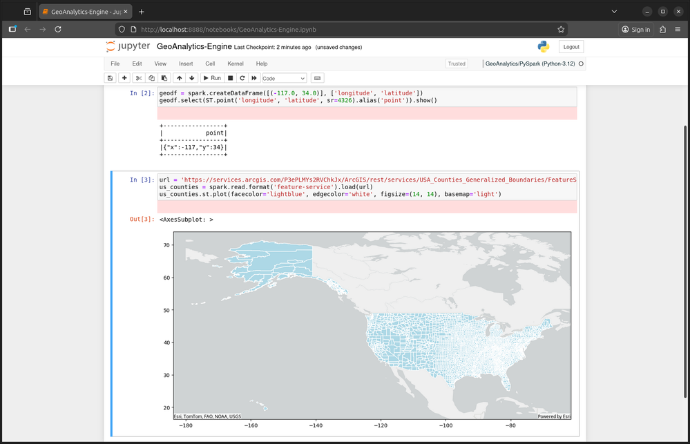

We can also check with some basic creation of a DataFrame and plotting a map to confirm that the functionality is all working as expected:
