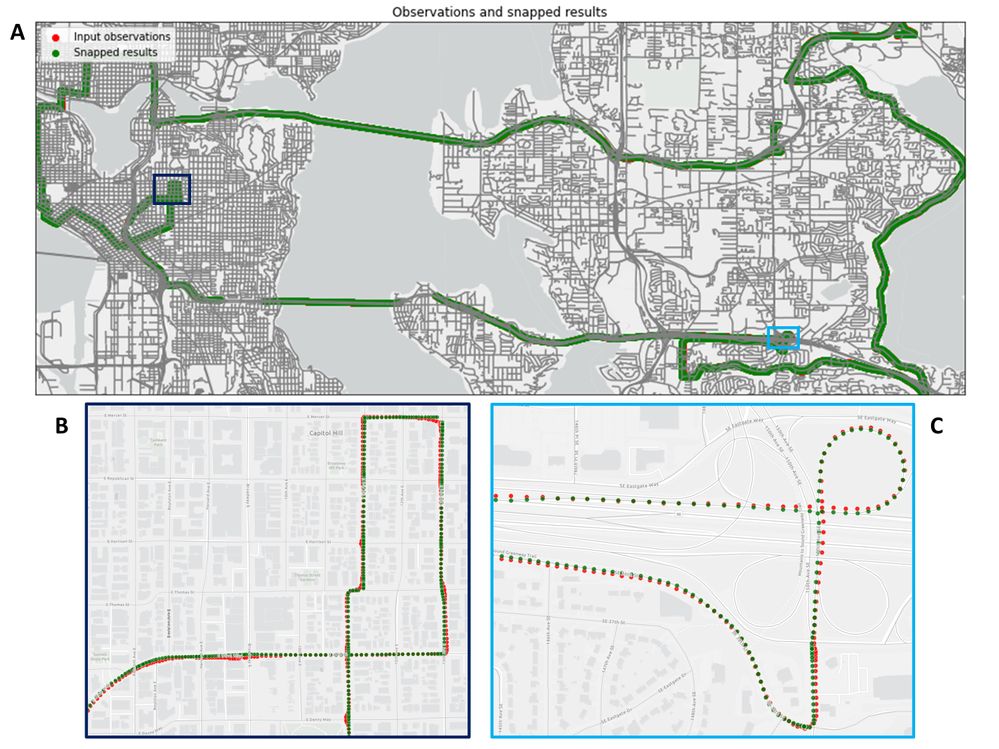

The code snippets below demonstrate an example use case of Snap Tracks using 1) a freely available  test GPS dataset from a drive on January 17, 2009, in the Seattle, WA area, and 2) the road network data of greater Seattle, WA. Figure 1 shows the output of the tool that snapped the raw GPS points to the traversed road network.

# Visualization
points_extent = gps_data_pnt.st.get_extent()
adj = 0.0002
# Add the streets, original observations points, and snapped points to the plot
lines_ax = roads_data_line.st.plot(aspect="equal", color="grey", figsize=(16,10))
points_ax = gps_data_pnt.st.plot(ax=lines_ax, color="red", label='Input observations')
points_ax.set(frame_on=True, xticks=[], yticks=[], xlim=((points_extent.min_x-adj), points_extent.max_x+adj), ylim=(points_extent.min_y-adj, points_extent.max_y+adj))
points_ax = result.st.plot(ax=points_ax, color="green",legend = True, label='Snapped results', basemap="light")
leg = points_ax.legend(loc=2)
points_ax.set_title("Observations and snapped results");
Figure 1. a) GPS points snapped to the traversed road network across the Seattle area; b, c) zoomed-in views to highlight two road segments where green points and red points correspond to the snapped (on to the actual road) and raw GPS points, respectively.
