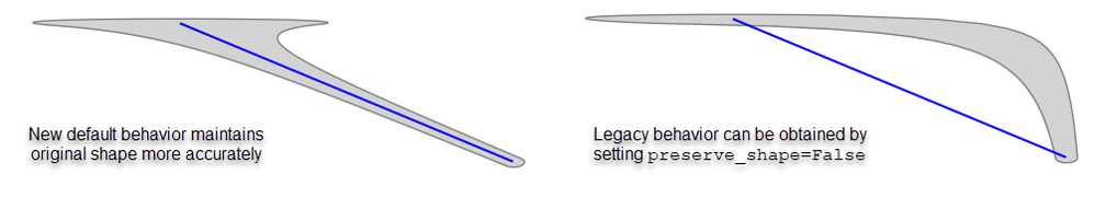

ST_GeodesicBuffer will preserve geographic location of the input geometry's interior by default
Change: In GeoAnalytics Engine 2.0, the default behavior of ST_GeodesicBuffer will be changed to preserve the geographic location of the input geometry’s interior, more accurately maintaining its original shape. You may see differences in the geometry returned with ST_GeodesicBuffer if you rely on the default behavior.
Mitigation
To return to the legacy result of the function, set the new “preserve_shape” parameter to False. By default, the parameter is set to True in GeoAnalytics Engine 2.0. Refer to the developer documentation and API guide for additional information on the updates to the function.
