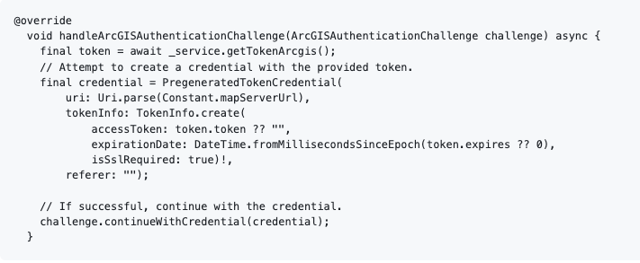

It works unstable, sometimes it authenticates successfully, sometimes it fails.
Log error:
Unhandled Exception: ArcGISException: code=18004; A token or API key is required.; A token or API key was not provided to access https://arcgis.xyz.vn/arcgis/rest/services/xyz/MapServer/

Actually re-reviewing your code, with the PregeneratedTokenCredential, this is slightly different to the TokenCredential workflow. Are you looking to have a user login experience in your app? If so, you can either use the TokenCredential or OAuthUserCredential workflows. For these you need to override the handleArcGISAuthenticationChallenge method.
If you are looking to use a pregenerated token, then this is for the workflow where you are using a token generated outside of your application. i.e. you can just get your pregenerated token and add this to the credential store - you just need to make sure you do this before you load the map or any secured services you are using.
ArcGISEnvironment.authenticationManager.arcGISCredentialStore.add(credential: pregeneratedTokenCredential);
