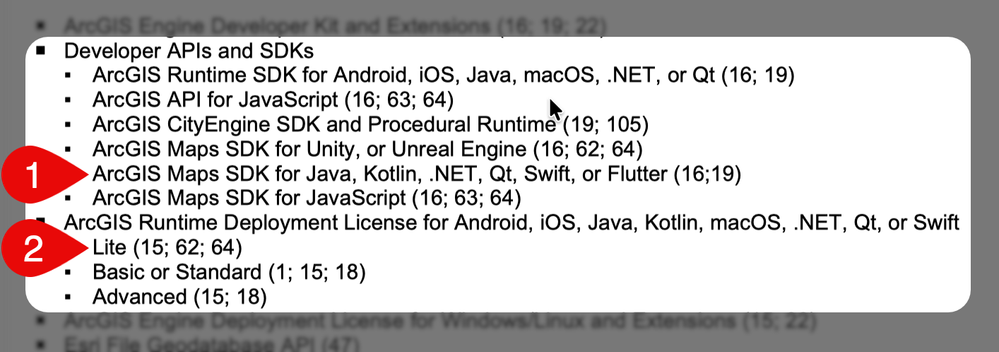

The key consideration here is this: the expectation is that with a Lite license you will be using the SDKs with one of our foundational products (ArcGIS Online, ArcGIS Location Platform, ArcGIS Enterprise, or ArcGIS Pro) in some way.
This is expressed by item 62 of our E300 product-specific terms of use: "Value-Added Applications must be used in conjunction with other Esri Products."
In the case of ArcGIS Online or ArcGIS Location Platform, you're consuming paid services. Or your might be using ArcGIS Pro to create mobile map packages or network datasets for offline use, etc. etc.
You can determine the product-specific terms in that document which apply to Flutter at Lite under the Developer Products section:
To provide a more concrete answer, I'd have to understand how you will be using the SDK. I'm happy to discuss. Feel free to DM me if you prefer.
