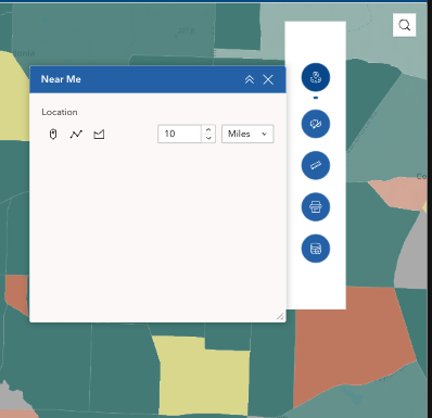

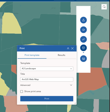

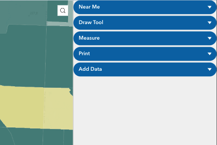

The Problem: The "Icon Guessing Game"
The default Widget Controller pattern is space-efficient but relies entirely on icon recognition. For specialized tools, a small icon doesn't always convey the full purpose, forcing users to click through every tool to find what they need.
Screenshot 2026-01-26 at 4.32.49 PM.pngScreenshot 2026-01-26 at 4.32.58 PM.png
Standard icon-only controller: Compact, but requires the user to know what each symbol represents.
The Solution: The Accordion Tool Menu
By replacing the Controller with an Accordion Widget, we provide clear, human-readable labels. This immediately clarifies the application's capabilities without cluttering the map.
The Accordion approach: Large, legible tap targets and clear labels (Near Me, Draw Tool, Measure, etc.) improve accessibility and discoverability.

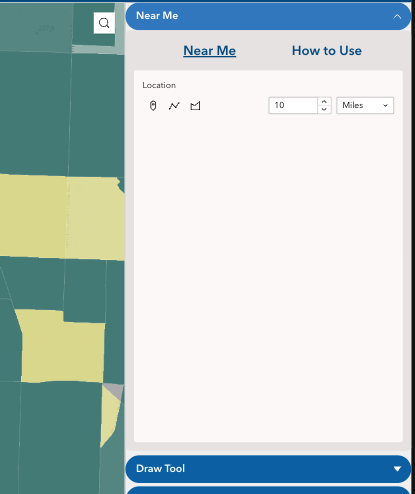

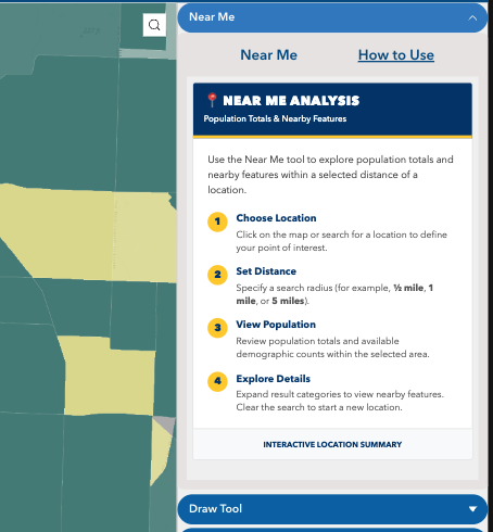

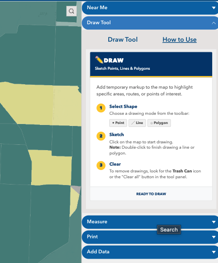

The Innovation: In-Context "How to Use" Guidance
The true power of this pattern is providing instruction at the exact moment of use. Instead of a separate help page, we embed a "How to Use" view inside every tool panel.
Left: The tool view. Right: The "How to Use" view providing step-by-step instructions for the specific widget.
By using a Section Widget inside the accordion item, we can toggle between the functional tool and a set of instructions. This ensures that users are never "stuck" wondering how to interact with the map.

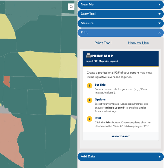

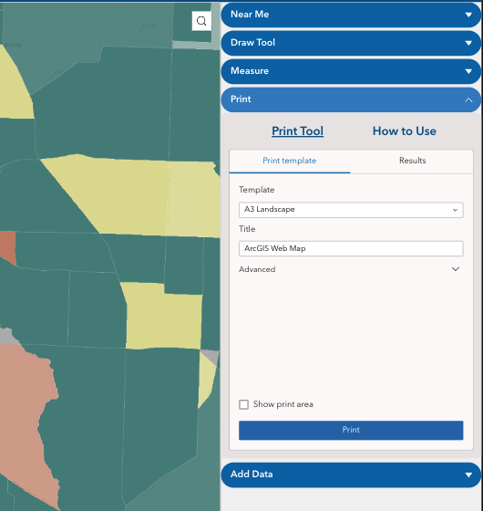

Consistent Guidance Across All Tools
This pattern is easily replicable across any widget in your experience, from drawing and measuring to printing and data management.
The "Ready to Print" and "Ready to Draw" views provide just-in-time training, reducing the need for external documentation.
