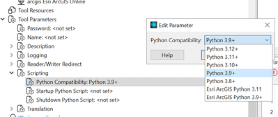

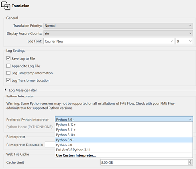

I did not find the "Esri ArcGIS Python 3.9+" interpreter in the FME Options - Translation - Python Interpreter tab.  It was in the workspace Tool Parameters - Scripting - Python Compatibility selection though.
I just selected the plain "Python 3.9+" for both, and I was able to run the entire workspace!  Thank you!

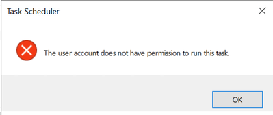

Now - I can't get past this....
BruceHarold
Esri Frequent Contributor
Ah, well that's one for your system administrator!  I guess your account will need some tweaking.
AdamRepsher_BentEar
That's me!
