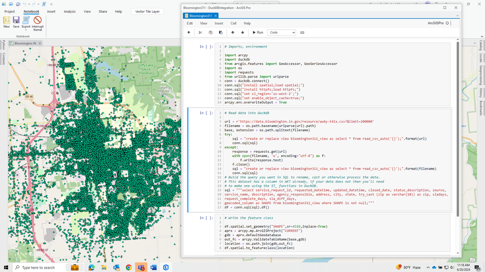

Here is some live action, Bloomington Indiana open 311 incidents migrated to a feature class in seconds.
Bloomington 311 IncidentsBloomington 311 Incidents
The notebook (in the blog download) reads a CSV file at a public URL and writes a feature class into the project default geodatabase.  Notebooks are a good place to start compared to a script tool because you can work in a cell interactively as you figure out your SQL.  Once things are working you might copy the code to a script tool for easy automation on a schedule.

Let's walk through each notebook cell.  The first one is pretty simple, the imports and some calls to duckdb to set up the environment.
# Imports, environment
import arcpy
import duckdb
from arcgis.features import GeoAccessor, GeoSeriesAccessor
import os
import requests
from urllib.parse import urlparse
conn = duckdb.connect()
conn.sql("install spatial;load spatial;")
conn.sql("install httpfs;load httpfs;")
conn.sql("set s3_region='us-west-2';")
conn.sql("set enable_object_cache=true;")
arcpy.env.overwriteOutput = True
The second cell makes a pandas dataframe by reading the CSV data while automatically inferring data types - such a big help.  You'll notice I code defensively for the situation the server I'm hitting doesn't support HTTP range request access like DuckDB wants - I download the data - which in this case was necessary.
# Read data into duckdb
url = r'https://data.bloomington.in.gov/resource/aw6y-t4ix.csv?$limit=200000'
filename = os.path.basename(urlparse(url).path)
base, extension = os.path.splitext(filename)
try:
    sql = "create or replace view bloomington311_view as select * from read_csv_auto('{}');".format(url)
    conn.sql(sql)
except:
    response = requests.get(url)
    with open(filename, 'w', encoding="utf-8") as f:
        f.write(response.text)
    f.close()
    sql = "create or replace view bloomington311_view as select * from read_csv_auto('{}');".format(filename)
    conn.sql(sql)
# Build the query you want in SQL to rename, cast or otherwise process the data.
# This dataset has a column in WKT already, if your data does not then you'll need
# to make one using the ST_ functions in DuckDB.
sql = """select service_request_id, requested_datetime, updated_datetime, closed_date, status_description, source,
service_name, description, agency_responsible, address, city, state, try_cast (zip as varchar(10)) as zip, sladays,
request_complete_days, sla_diff_days,
geocoded_column as SHAPE from bloomington311_view where SHAPE is not null;"""
df = conn.sql(sql).df()
Note the point about using or creating WKT values for your geometry.  The spatial extension for DuckDB has a rich set of spatial functions.
Now convert the dataframe to a feature classYou have other conversion options. Note that the arcgis Python API has no idea where the dataframe came from - DuckDB will do fine! - so I spatially enable the dataframe and then write to a geodatabase feature class.  No wrangling of attribute field properties, they just work (see the SQL above, the classic situation of casting ZIP codes to text came up).
# Write the feature class
df.spatial.set_geometry("SHAPE",sr=4326,inplace=True)
aprx = arcpy.mp.ArcGISProject("CURRENT")
gdb = aprx.defaultGeodatabase
out_fc = arcpy.ValidateTableName(base,gdb)
location = os.path.join(gdb,out_fc)
df.spatial.to_featureclass(location)
Lastly, announcement!
print("Created feature class {}".format(location))
That's it, fast, simple, smart migration of data with some help from DuckDB!
