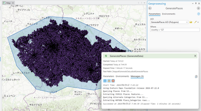

Here's 350K places of interest points in the Czech Republic I generated on demand, with descriptive base table fields and related alternate category descriptions, all as features in ArcGIS Pro's memory workspace.  You can make your own data for any area of interest worldwide using the data generation script tool in the blog download.  You'll need ArcGIS Pro 3.5+ and a few seconds of your time - in my case 35 seconds for the Czech data (that's 761422 features total between the place points and lookup table).

In the case of the post's tool, the spatial component is an input parameter of polygon data (any coordinate system, any number of polygons, the pale blue feature in the map) that encloses an area of interest, and for a non-spatial component, an optional where clause to be applied in addition to the area of interest.  In the case of the data shown, the clause was country = 'CZ'.  You should make some test data in a small area of interest to refine any where clause you need - the clause must use identifiers from the output data schema and DuckDB SQL syntax.

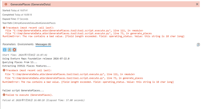

However, there’s one thing that concerns me. At first, I ran the tool in ArcGIS Pro 3.6 and was able to load the GeoParquet data without any issues. But after updating Pro to version 3.7 and running the tool again, I got an error and it wouldn’t run (it appears to be an error that occurred while executing the Python script).
If you have some time, could you please test how it works in version 3.7? (Unfortunately, I’m not familiar with Python, so I can’t debug it myself.)

@MasanobuHIRANO Thank you for trying out the sample.  The error you found is my fault, I had a typo in the code that made the operating_status field too small to hold the data, I have edited line #61 in the GeneratePlaces tool source to correct that, it's now 20 bytes wide, not 10.  I also increased the width of the address field from 300 to 350 bytes, I had an error there too.  I think the data is crowd sourced and strange values can creep in.

@BruceHarold Thank you for making the corrections to the Python tool so quickly.
The GeneratePlaces tool worked fine in my ArcGIS Pro 3.7 as well.

You mentioned that it took 35 seconds to load the Czech data, but in my environment, it took 1 minute and 16 seconds. I’m using a Toshiba dynabook (CPU: Intel Core Ultra 7 155H 1.40 GHz, Memory: 32 GB, OS: Windows 11 Pro), and my internet download speed was 280 Mbps (measured using fast.com).
