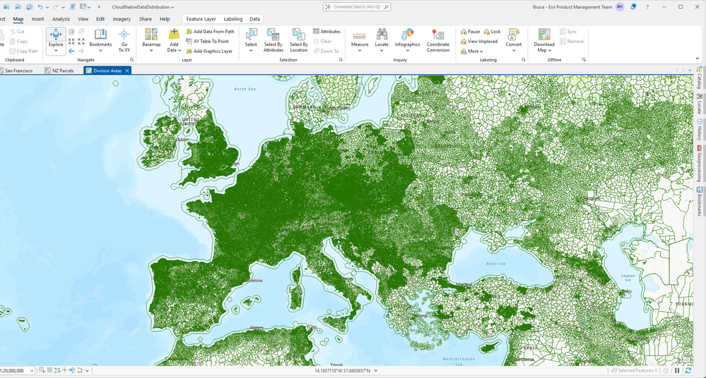

My subject matter data is Overture Maps Foundation Division Area features, a global scale dataset released monthly.  The data model includes polygon geometry with a primary place name and a struct object with alternate names in many languages.  The source data at writing are ten GeoParquet files in AWS S3, with a common schema.  There is no logical partitioning.  The information product I want is a geodatabase feature class, related alternate name table plus a geocoding locator that understands all the names.  Here is what the feature data looks like over Europe:
Division AreasDivision Areas
To use my information product, for example if I want to find Madrid in Spain using the Bihari language (the popup shows available names for Madrid) I give मैड्रिड as the address:
मैड्रिड finds Madridमैड्रिड finds Madrid

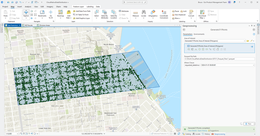

Here is an example query where I extract into a memory feature class all 311 cases to-date for 2026 within a polygon - this took 4 seconds.  There are about 8500 features.
San Francisco QuerySan Francisco Query
The query tool is a script tool, its secret sauce is the QUALIFY clause.  The GeoParquet files made from daily case data will have duplicates due to the case lifecycle (opened one day, edited another day, closed a later day) then we want only the most recent row per service_request_id value across all GeoParquet files - the QUALIFY clause when querying the parquet data does this for us.

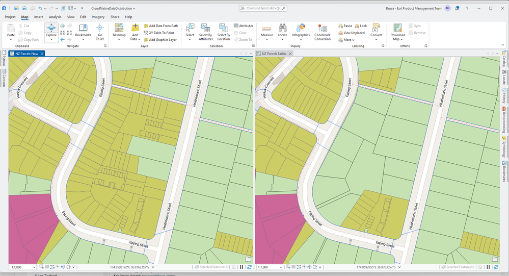

Data subject to heavy branch versioned editing is high value work for GIS, and while you can share the data state by giving access to its underlying feature services, adding a public mapping workload to the server will not be welcomed by the administrator.   It turns out you can share the state of the data, with support for time travel, using a cloud-native approach.  What enables this is the insert-only data model of branch versioning - the state of a feature at any moment is determined by GDB_FROM_DATE in combination with OBJECTID - the row with latest GDB_FROM_DATE for each unique value of OBJECTID is the current state of a feature, and if you query for earlier GDB_FROM_DATE values you get time travel.  The only trick is making GeoParquet files that represent edit moments, but then the QUALIFY clause comes to the rescue again to deliver the data you want.
Here are two views of parcel data over the same extent and using the same source GeoParquet files.
Current and earlier momentsCurrent and earlier moments
The left view is the latest moment, the right view is at an earlier moment, you can see a lot of parcel subdivision has taken place.  The data source retains the full data history, edits result in new GeoParquet files being added to a folder or cloud object store.  Here I have a baseline 1.46GB GeoParquet file for the original state of the data with a couple of small GeoParquet files containing edits over two weeks.
GeoParquet files containing full data historyGeoParquet files containing full data history

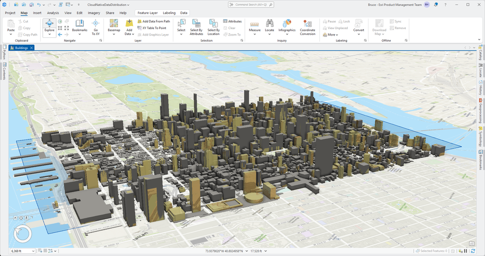

Now, while I hope to see you at the 2026 User Conference in San Diego, if you need more encouragement then here is sneak preview of a demo bringing Overture Building theme data into a scene. See if you can find a couple of easter egg script tools in the blog download 😉.
Overture BuildingsOverture Buildings
