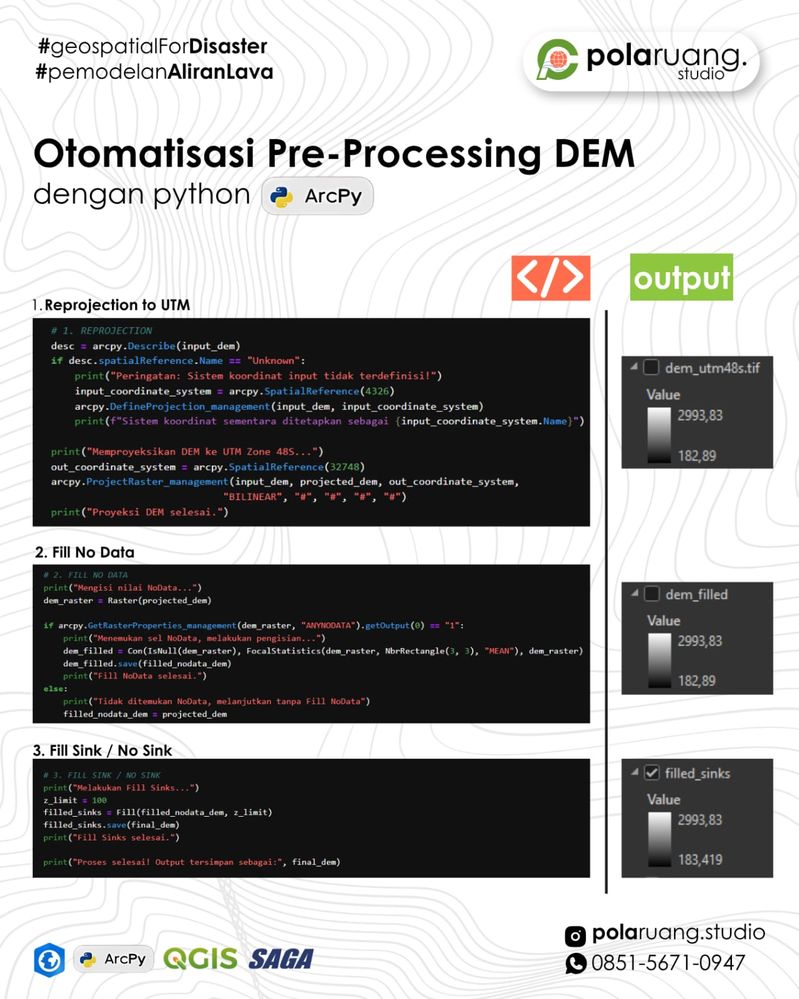

1. Automating DEM Pre-Processing using ArcPy The reliability of any simulation heavily depends on the quality of the topographic data. Instead of executing manual pre-processing steps, I wrote a Python script utilizing the ArcPy library to automate several crucial geoprocessing tasks, including:
  • Reprojection to UTM (Zone 48S)
  • Fill NoData (using Focal Statistics evaluation)
  • Fill Sink (removing artificial depressions in the DEM)
Using ArcPy saved a significant amount of time, especially when iterating the data across different potential volcanic vent areas.

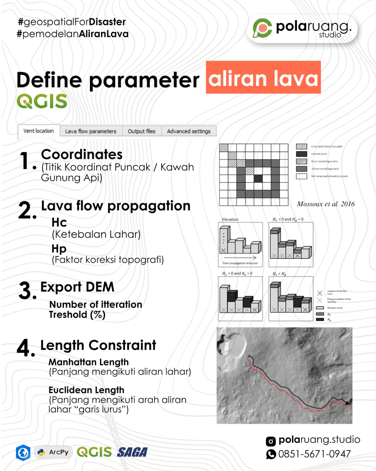

2. Lava Flow Parameters and Simulation Once the DEM was prepared and exported, I moved into the simulation phase. The modeling combines two distinct approaches:
  • Probabilistic Model (Felpeto et al., 2001): To model the lava spread based on elevation.
  • Deterministic Model (FLOWGO): A thermo-rheological approach to predict flow length, incorporating conductive cooling and viscosity variables.
Additionally, I included topographic correction factors, namely Lava Thickness (Hc) and Depression Filling Factor (Hp) to ensure the simulation respects the physical terrain constraints.

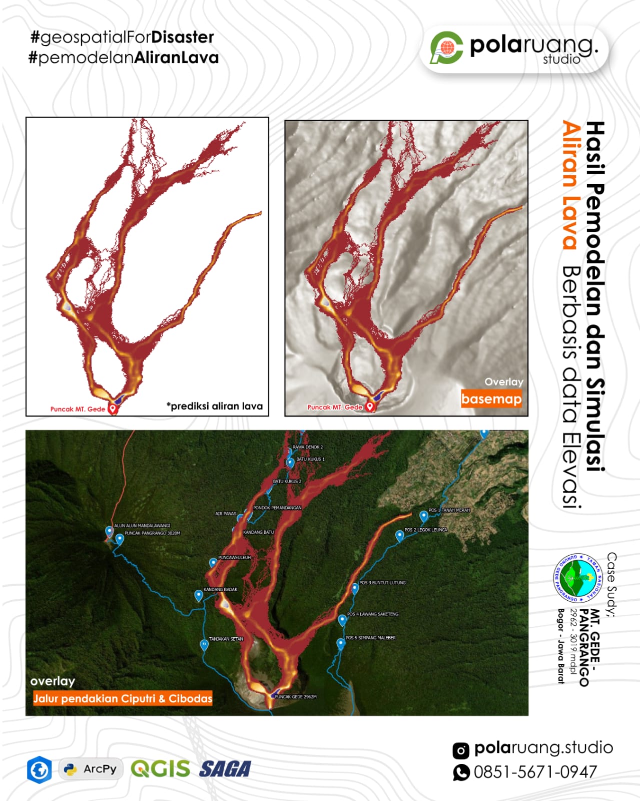

3. Results and Spatial Overlay The simulation successfully generated predicted lava invasion paths. To apply this to a disaster mitigation context, I overlaid the spatial output with existing conditions. The results clearly illustrate how potential lava flows could intersect vital hiking trails and evacuation routes on Mt. Gede-Pangrango.
