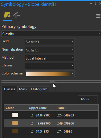

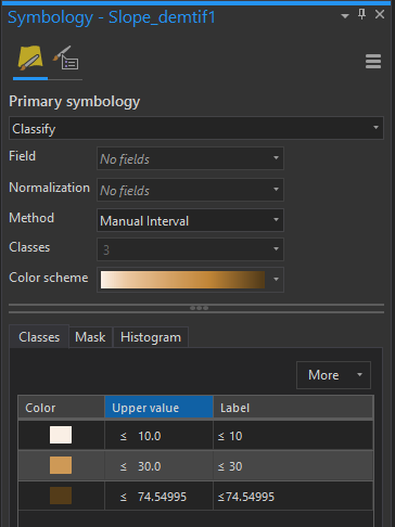

Another thing you can try is to set the symbology of your slope layer first. You can first set Equal Interval method in Symbology pane and select number of classes as 3. Then manually edit the Upper value column with the break values you want.
Now if you go back and open Reclassify tool, and select your slope layer as the input raster, the Reclassification table parameter will get the class break you set in the Symbology. So you don't need to manually type in any values.
