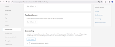

IrinaRodriguez
Hello, same issue but I do have an organizational account. I can see that the ArcGIS World Geocoding Service is available in my portal
but it's empty when using arcgis pro geocode tool
