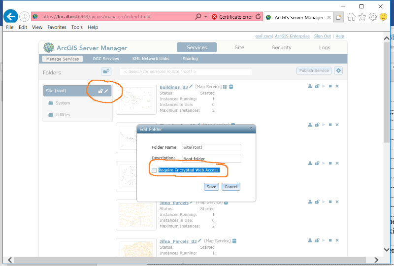

MajdoleenO_A__Awadallah
Thank you Randall Williams  for your reply, it is very helpful.
So, we can conclude that the main effect of (Require Encrypted Web Access) at the level of  the folder in Arcgis server is to disable the http (enforce https) and only work with https, Please have a look on the attach!

Why bother guessing when you can just test it.  It seems you already have ArcGIS Server deployed, and are experimenting with changing the setting.
