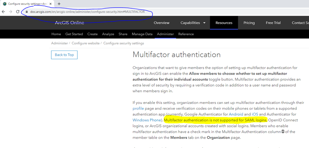

@RandallWilliams  - Hi Randall - Please see the highlighted text below - Does the highlighted text indicate that the 'OOTB' AGOL MFA will not work with a SAML login?  BUT that our in-house IDP'S SAML MFA should work with AGOL (Field Maps, Collector)?  I'm asking to make sure that if we implement SAML we may also have MFA for Fields Maps, Collector.  Hope my question makes sense
thanks
-Nick

Looks like that doc needs some improvement, I can see the confusion.
You are correct - the OOTB MFA does not work with organization-specific logins like SAML, but the SAML providers OWN MFA absolutely will work. In fact, many of the ArcGIS Online ORGs we manage here internally at Esri leverage OKTA, in which our configuration requires MFA.
Check out our Organization Specific logins FAQ in our ArcGIS Trust Center documents , we get deeeeep down in this technical paper. Let us know what you think!
