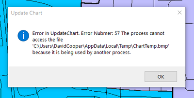

DavidCooper
Does anyone know how to fix this error?
AZendel
David Cooper, have you tried closing down all ArcMap/Catalog sessions and then deleting that file?
DavidCooper
Thank you for responding AZendel, I was able to fix the issue by rebooting my laptop. I am finding it to be a real chore to get this done in districting in ArcMap and with the announcement that it may be mid September before the 2020 data is available for the redistricting app I find myself searching the net for any and all tutorials on the districting extension for arcmap. would you happen to know of any?
