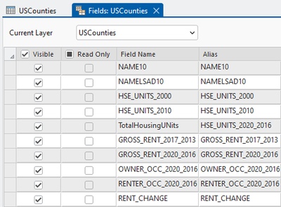

working thru Assignment 1-1 of GIS Tutorial for Pro 3.1. Page 2 of instructions refers to fields in US Counties layer as GROSS_RENT, HSE_UNITS, RENTER_OCC, RENT_CHANGE.
These fields do not exist in the US Counties layer downloaded with the assignment data.

I am currently able to see the GROSS_RENT, HSE_UNITS, RENTER_OOC, and RENT_CHANGE fields (see screenshot below).
To open the Fields view of the USCounties layer, right-click the layer in the Contents pane. Then, click Attribute Table. On the top ribbon, click the Data tab. In the Data Design group, click Fields
If you still aren't able to see the fields, I recommend re-downloading and extracting a fresh data set zipfile. If you encounter any more issues, please let us know!
