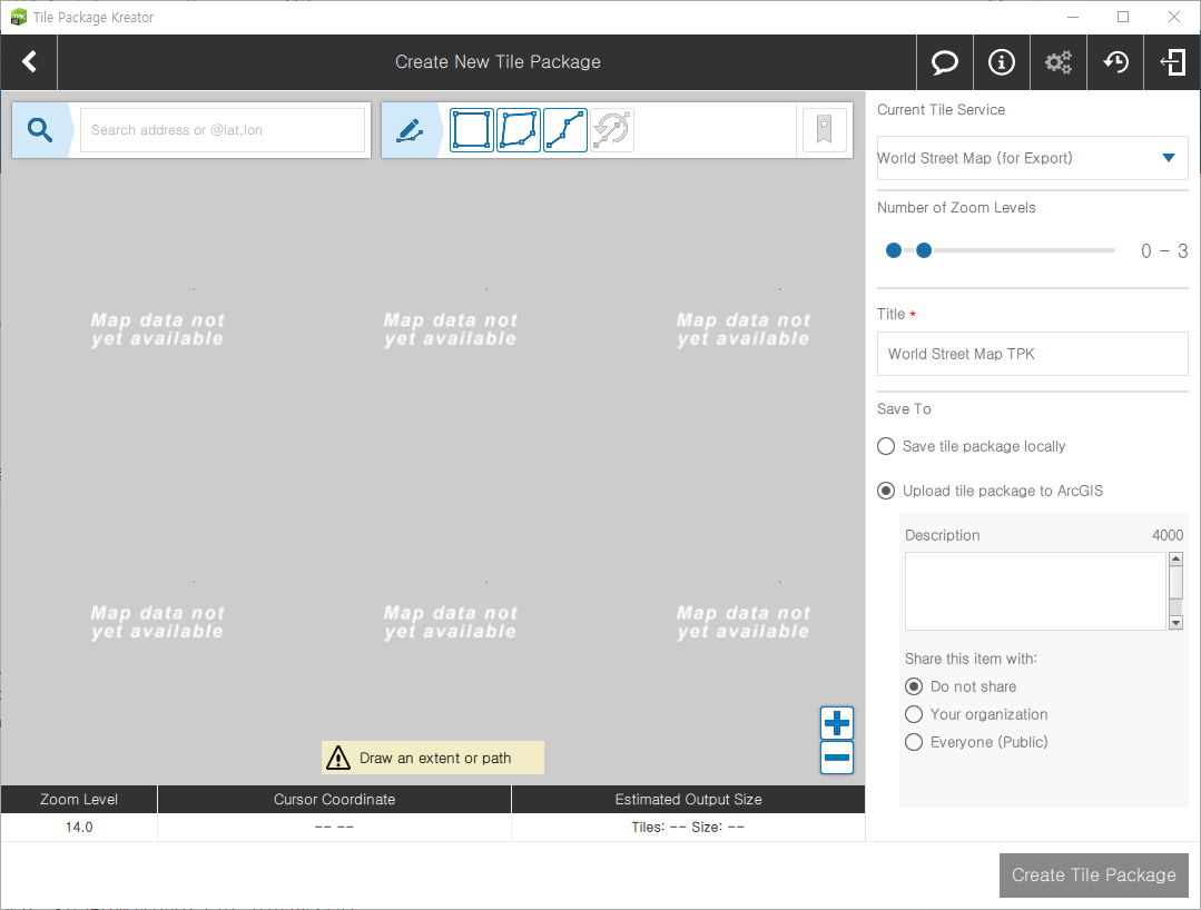

Basemaps on Tile Package Kreator are hosted in tiledbasemap.arcgis.com.
In these basemap, zoom level is limited on some district, So it is hard to use.
ex) Korea..

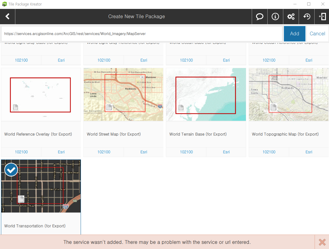

So, I tried to add basemap below link.
- https://services.arcgisonline.com/ArcGIS/rest/services/World_Imagery/MapServers
But it failed with below message
"The sevice wasn't added. There may be a problem with the service or url entered"
Are there any method to add agol basemap in TPK?

Hi Su-hyun,
First, it looks like the exact URL you are specifying is invalid (it should end in /MapServer, not /MapServers).  Second, the online basemaps hosted on services.arcgis.com cannot be used for TPK export; the "for Export" services are specifically designed for that purpose. If you see an area where the "for Export" service is not showing the same result as the main services, please work with the Community Basemaps team to address this (this will probably also require coordination from Esri Korea).
