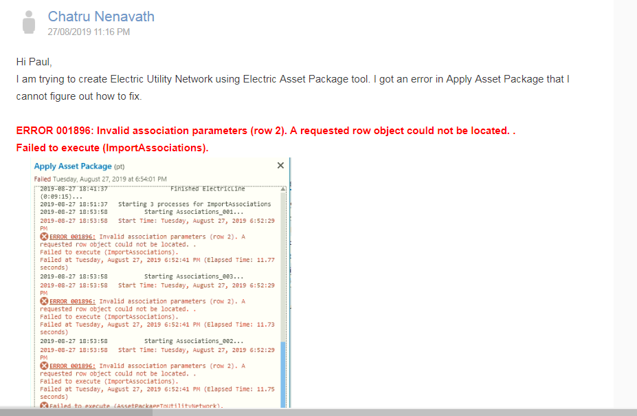

Hi
I have got the data but I could not able to proceed further due to the errors seen.

Are you loading the sample data?  We have seen issue with parallel processing.  You can set it to 1 in the environment variables of the tool or run this in the python window prior to running apply asset package.
arcpy.env.parallelProcessingFactor = 1
