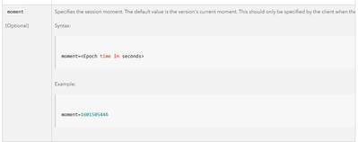

The ExportSubnetwork REST API supports "moment" parameter which lets you export the subnetwork as of a given time.
https://developers.arcgis.com/rest/services-reference/enterprise/exportsubnetwork-utility-network-se...
So maybe you could do a call to get current and a historic version -> compare and decide if you want to send this update to OMS.
This way gives you the flexibility to ignore the update if it's not meaningful example only one vertex has changed in the subnetwork then don't send to OMS. But if you new customers are added then send to the OMS.
