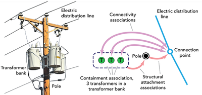

Hi Charlotte,
An association defines the relationship between two data objects - without creating a physical feature/object. Those relationships can be connectivity - in which case electricity will flow from one object to another; or if it's attachment - then the relationship it establishes is that one feature is attached - physically - to the other, even if that relationship is not apparent from the physical features. Attachment will not allow flow of electricity between objects in the data model.
This is a picture I snagged a few years ago from ESRI:
The associations are those purple/pink lines; not physically drawn in the data model but define relationships between objects.
I hope this helps!
