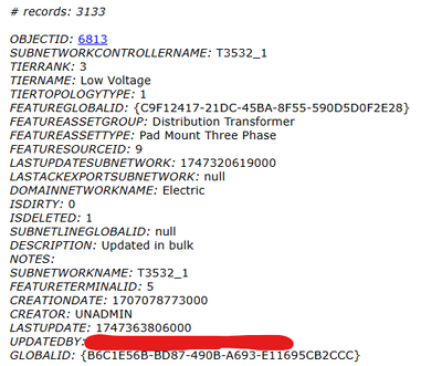

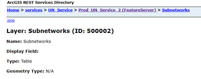

Subnet Line is one way of getting all subnetworks but I believe a better way is to use the subnetworks table for this. This is layer id 500002
https://{Your Site}/server/rest/services/UN_Service/Prod_UN_Service_2/FeatureServer/500002/query?where=1%3D1&objectIds=&time=&geometry=&geometryType=esriGeometryEnvelope&inSR=&defaultSR=&spatialRel=esriSpatialRelIntersects&relationParam=&outFields=*&returnGeometry=true&maxAllowableOffset=&geometryPrecision=&outSR=&havingClause=&gdbVersion=&historicMoment=&returnDistinctValues=false&returnIdsOnly=false&returnCountOnly=false&orderByFields=&groupByFieldsForStatistics=&outStatistics=&returnZ=false&returnM=false&multipatchOption=xyFootprint&resultOffset=&resultRecordCount=&returnTrueCurves=false&returnCentroid=false&timeReferenceUnknownClient=false&maxRecordCountFactor=&sqlFormat=none&featureEncoding=esriDefault&datumTransformation=&cacheHint=false&f=html
Response
Two distinct advantages -
1) This will show you the Tier Name i.e the non-coded value
2) This will also show subnetworks where there may not be a subnet line.
For example - A Distribution Transformer (LV subnetwork controller) without any LV Lines connected to it but has customers connected via associations. The "subnetline GlobalID" field will be blank for such instances.
Bonus advantages -
It will also show deleted subnetworks which you might want to clear out from the table periodically.
Also shows the last acknowledged date and last updated date which might help drive logic of when to export the subnetworks.
Hope this helps 🙂
