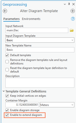

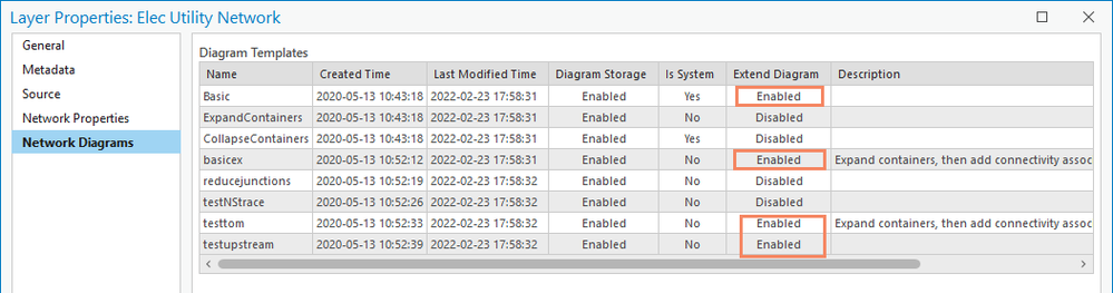

2/ The template related to your diagram is enabled to extend diagrams
