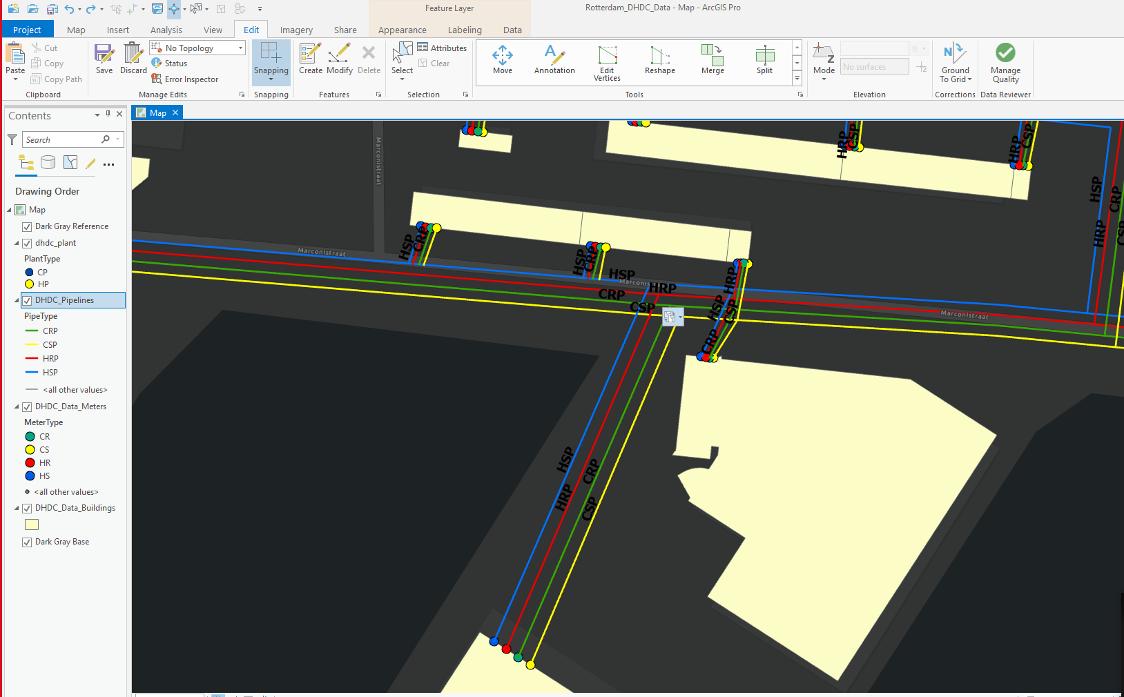

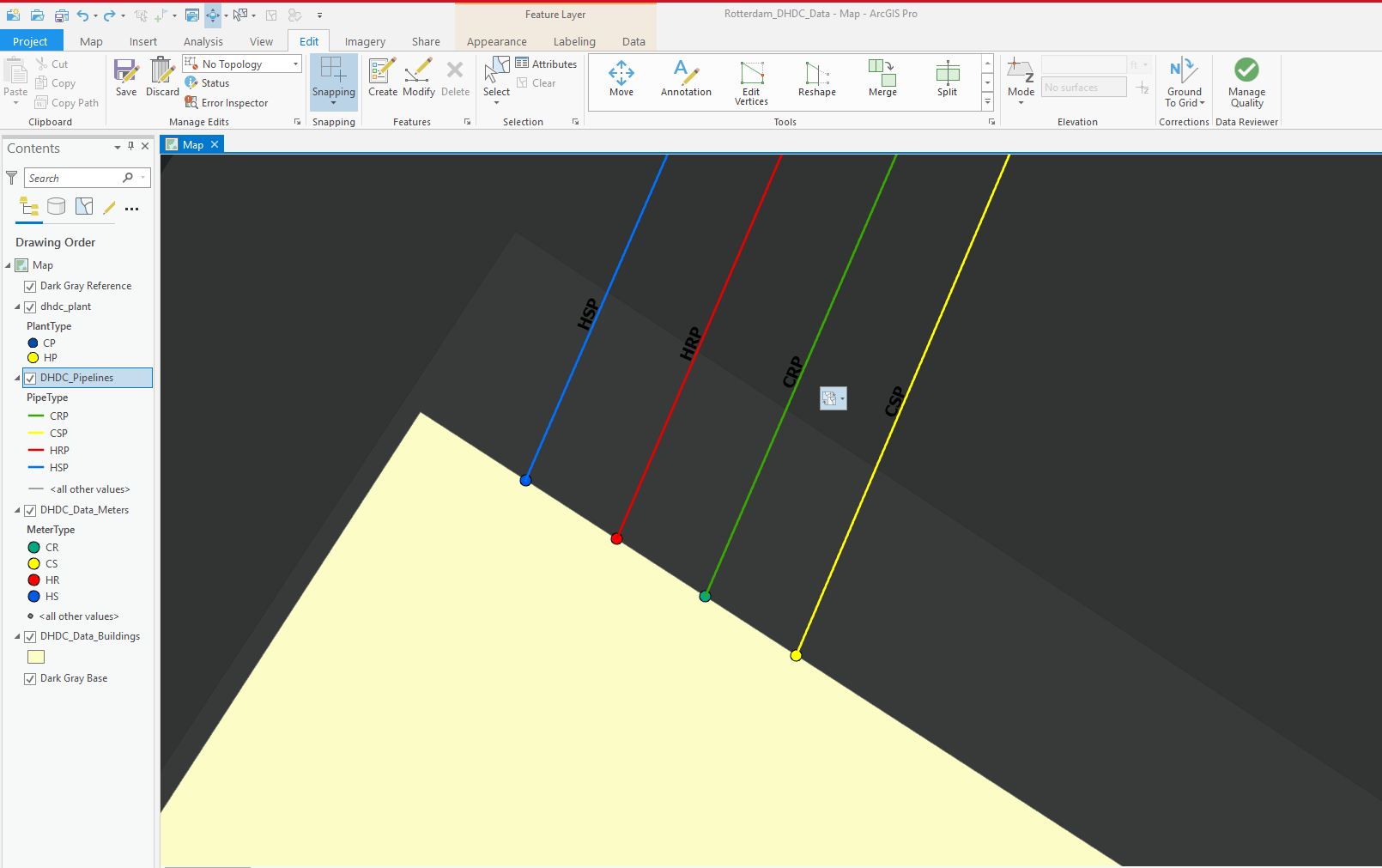

1. How do you usually model the supply and return pipes at the building level?
On the picture below I have 4 pipes (heating supply and return, and cooling supply and return) that are coming to the houses. At the end of each pipe I have meter. I assume I should actually have 2 meters instead of 4? What is your experience?
From my understanding DH and DC are closed loop systems, so technically inside (?) the building should be a connection of this two pipes. How do you usually model such situation?
