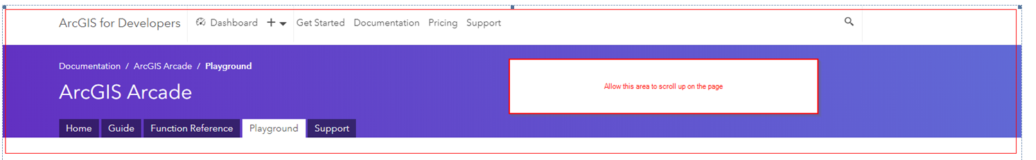

Fig 2 -- Header Allow to scroll-up on the Header
