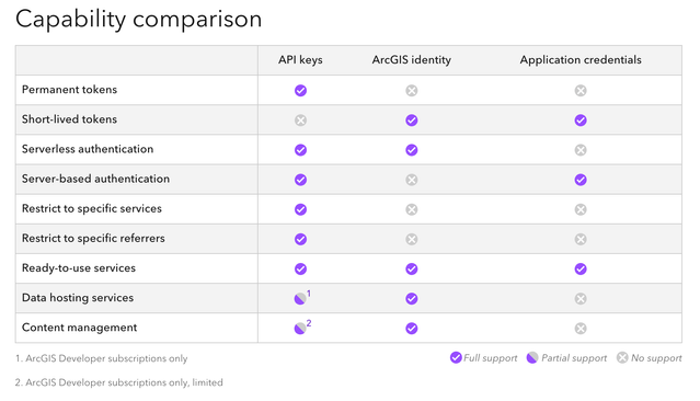

Does the Oauth app grant access to all Portal items, or is additional sharing required?
I'm afraid the token generated when using app credentials (client ID & client secret) won't allow you to access private data within the system.
Does the app need to need to use a built-in account, with required items shared with that account, or is access controlled by shared ownership (where owner of content and Oauth app are the same)
I'm not sure if you are familiar with the "Security and authentication" chapter of the "new" Mapping APIs and location services guide (they were published in January 2021). In case you aren't I would recommend you to take a look at it.
It includes this capability comparison with the different authentication methods:
Screenshot 2022-08-02 at 11.23.33.pngThere is an oAuth 2.0 page explaining that you can use OAuth 2.0 to get temporary access tokens that authorize your app with ArcGIS in one of two ways:
  • ArcGIS Identity
  • Application credentials <- as described in the article above
From these two methods, the one to grant access to data hosted in the system you would have to use ArcGIS Identity which means you need to use a built-in account as you described.
But, if you are using an ArcGIS Developer account you can also try API keys instead. The only thing to keep in mind is that it is still in ""Beta"", and it might suffer some changes in the future.
