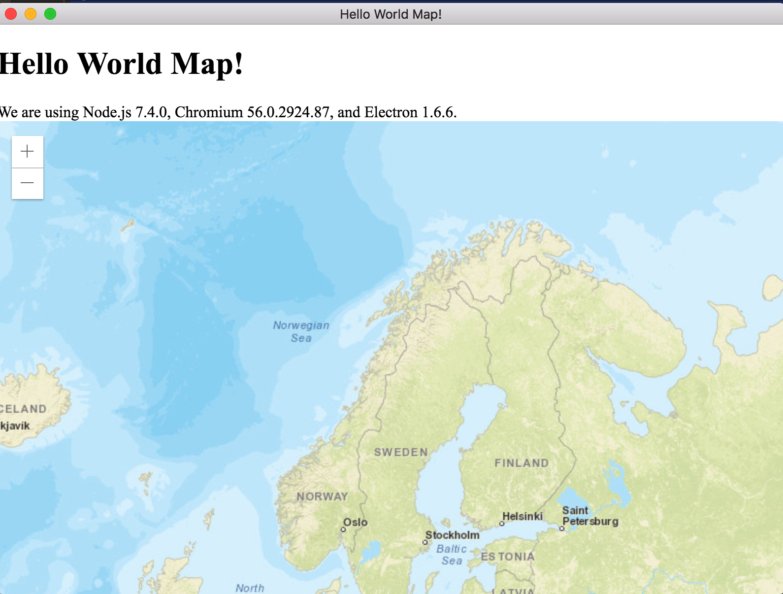

Step 4The last step is to run npm start again and you should see a map:
