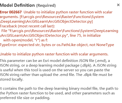

when I use detect objects,I meet this problem,but I dont konw how to solve it.Could you help me?
problem:
Unable to initialize python raster function with scalar arguments. [f:\arcgis pro\Resources\Raster\Functions\System\DeepLearning\ArcGISLearn\ArcGISObjectDetector.py]
File "f:\arcgis pro\Resources\Raster\Functions\System\DeepLearning\ArcGISLearn\ArcGISObjectDetector.py", line 75, in initialize
with open(model, "r") as f:
TypeError: expected str, bytes or os.PathLike object, not NoneType

002667: Cannot load python module.—ArcGIS Pro | Documentation
strange, the error number doesn't correspond to what you have posted, but I would check to ensure that you have the correct version of the deep learning framework in the link

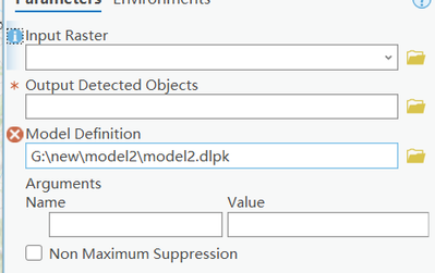

Thanks for your reply, now I find this issue maybe connect with my virtual environment.but i still dont know how to solve it

Could you please share the version of ArcGIS Pro you are using? Additionally, can you confirm how you created the deep learning environment? If you didn’t use the Deep Learning Libraries installer to set up the environment, you can download it from this page: https://github.com/Esri/deep-learning-frameworks.
The Deep Learning Libraries installer has been available since ArcGIS Pro version 2.6.
