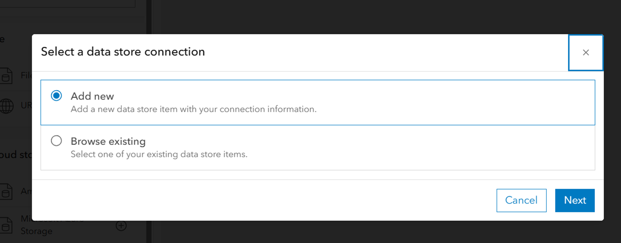

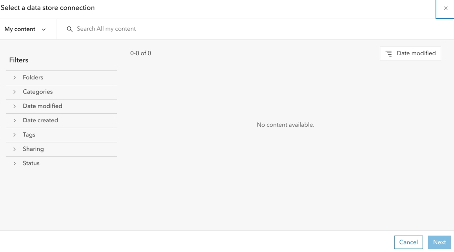

Another Observation is it is currently not providing the option to connect to Microsoft Azure.
What I am seeing in ArcGIS Online (AGOL):
What I am seeing on the Enterprise
Kindly support in resolving these issues.

Regarding your second observation, in ArcGIS Enterprise 12.0, you will need to create the Azure Storage data store item outside of Data Pipelines, specifically from the Content page. Once created, it will be available for selection within the app. This workflow is outlined in the Use Microsoft Azure Storage records Enterprise documentation.
