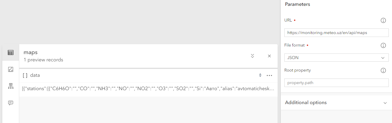

Please help to set correct root property path for input JSON https://monitoring.meteo.uz/en/api/maps
Without root property the connection tool returning one record

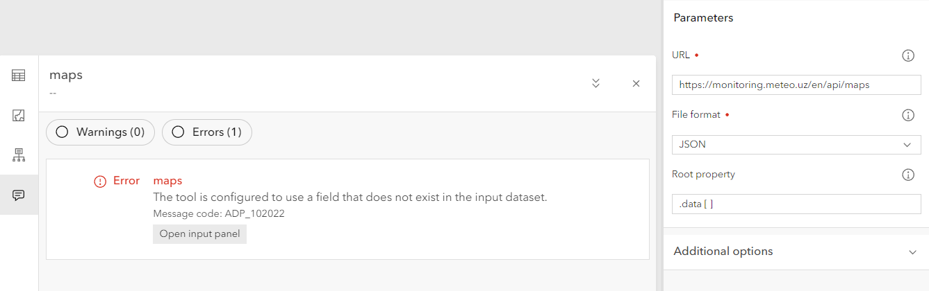

While I’m trying to use root property path statements like .data [ ] or .data [ ]. stations [ ] tool is returning error

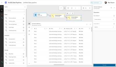

Hi, thanks for the question!
To get at this data, use "data" as the root property, then add two Unnest tools to flatten out the fields. The root property currently does not support accessing array entries (for example, "data[1]").
Here's a screenshot:

AlexLeonovDataPlusInt
Max, thank you very much! It's working beautifully!
