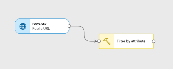

    1. Connect the Filter by attribute tool to the Public URL input from the previous step. Here is an image of what your data pipeline should look like after adding Filter by attribute:DuncanMackey_0-1686840251093.png

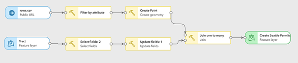

Here's an example of what your final diagram will look like if you have been following along:
To recap, we've loaded data from two different sources, done some basic transformations, filtered and spatially enhanced a dataset, and spatially joined the two datasets. We then outputted the results of all this work to a new feature layer, ready for further use in Online. Nice!
