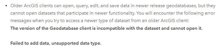

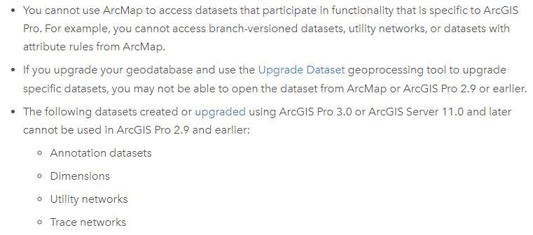

Answer:
1. Client and geodatabase compatibility
https://pro.arcgis.com/en/pro-app/latest/help/data/geodatabases/overview/client-geodatabase-compatib...
