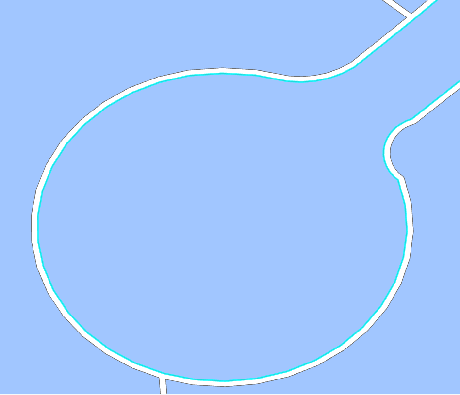

This is an example of an original densified polyline that makes up part of a polygon boundary shown next to the results of running the buffer tool on the same polygons with a negative 1-foot buffer (-1’).  Everything is as expected.

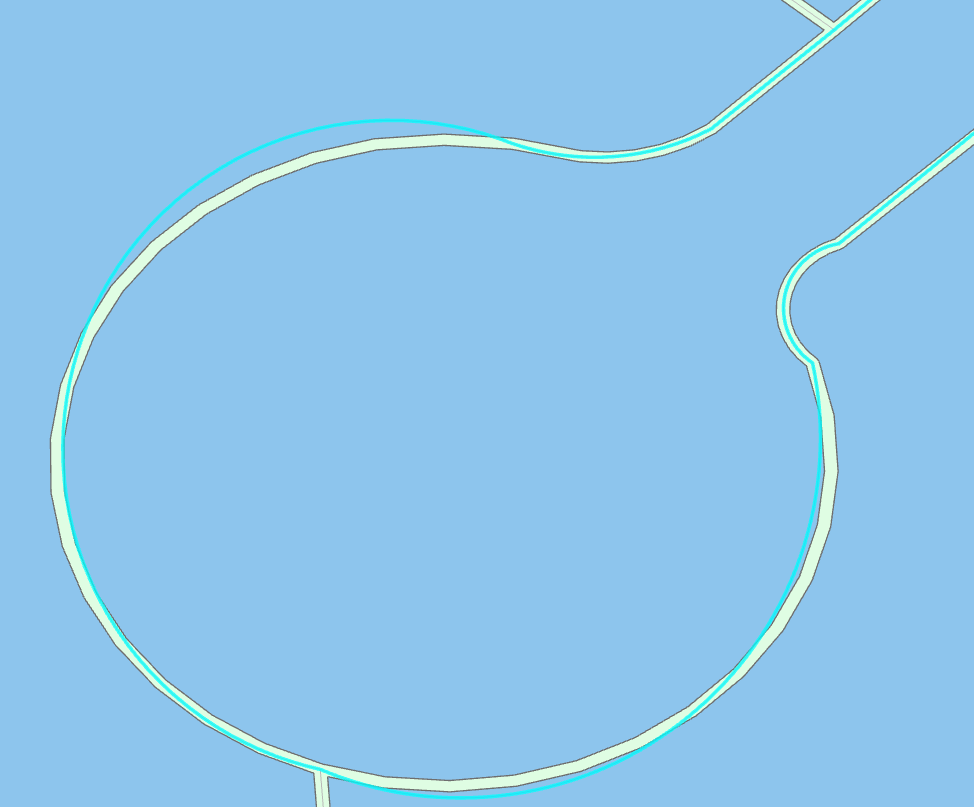

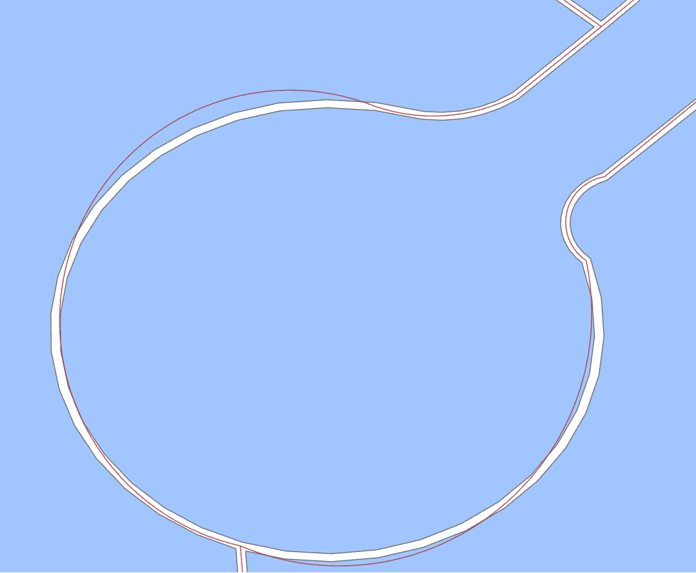

The dark red line below shows the output of the SLACA tool using a 0.5-foot distance tolerance allowance from the polyline edges.  The curves generated are clearly farther than 0.5 feet away from the original polyline edges (exactly 5’ offset rather than 0.5’ offset in the most extreme case as far as I can tell) and visibly cross into the -1’ buffer polygon.  However, when I use the Select by Location tool to find the set of SLACA lines that intersect with the buffer polygons, none of these lines are selected.

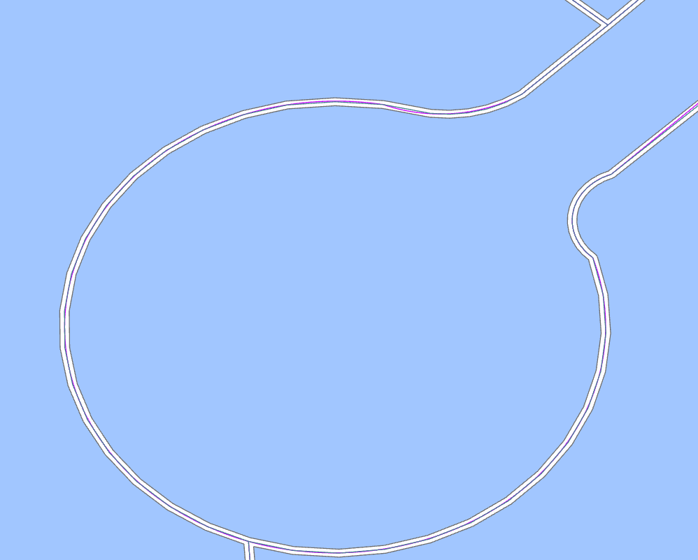

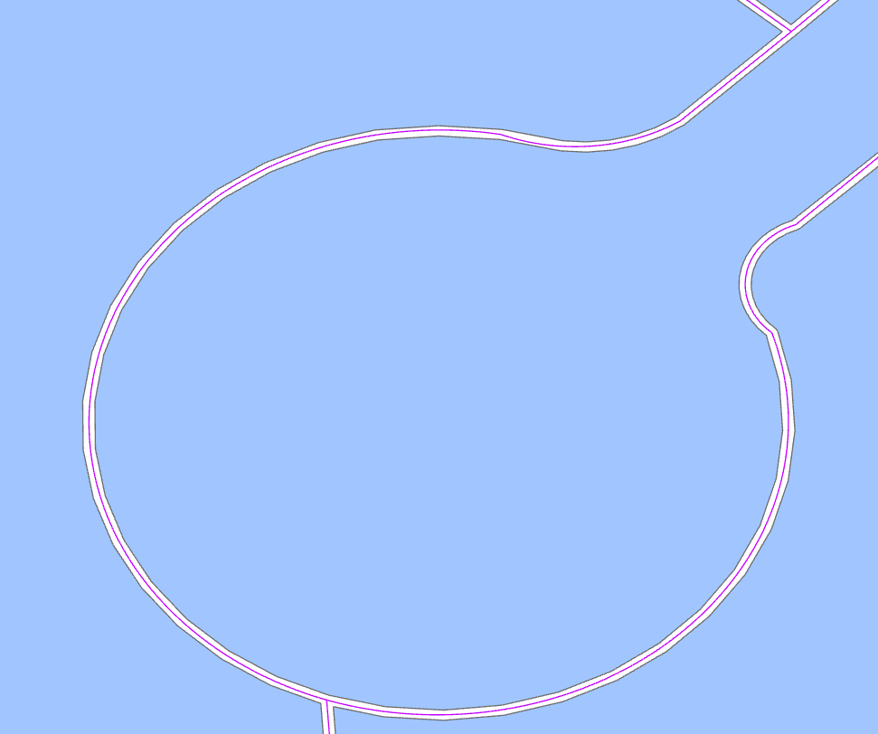

I created a copy of the SLACA lines and ran the Densify tool using the ANGLE option to only alter curves with a vertex placement at every 0.5-degree change.  The output line in purple is nearly restored to the original form of the polyline before I ran the SLACA tool when it did not intersect with the buffer polygons.  This is apparently the way the radial bend/curve geometry is being interpreted by the Select by Location tool which would explain why that tool did not identify any intersection between the two features.
The Densified Output Shown By Itself
The Original and Densified Polylines Overlaying Each Other.

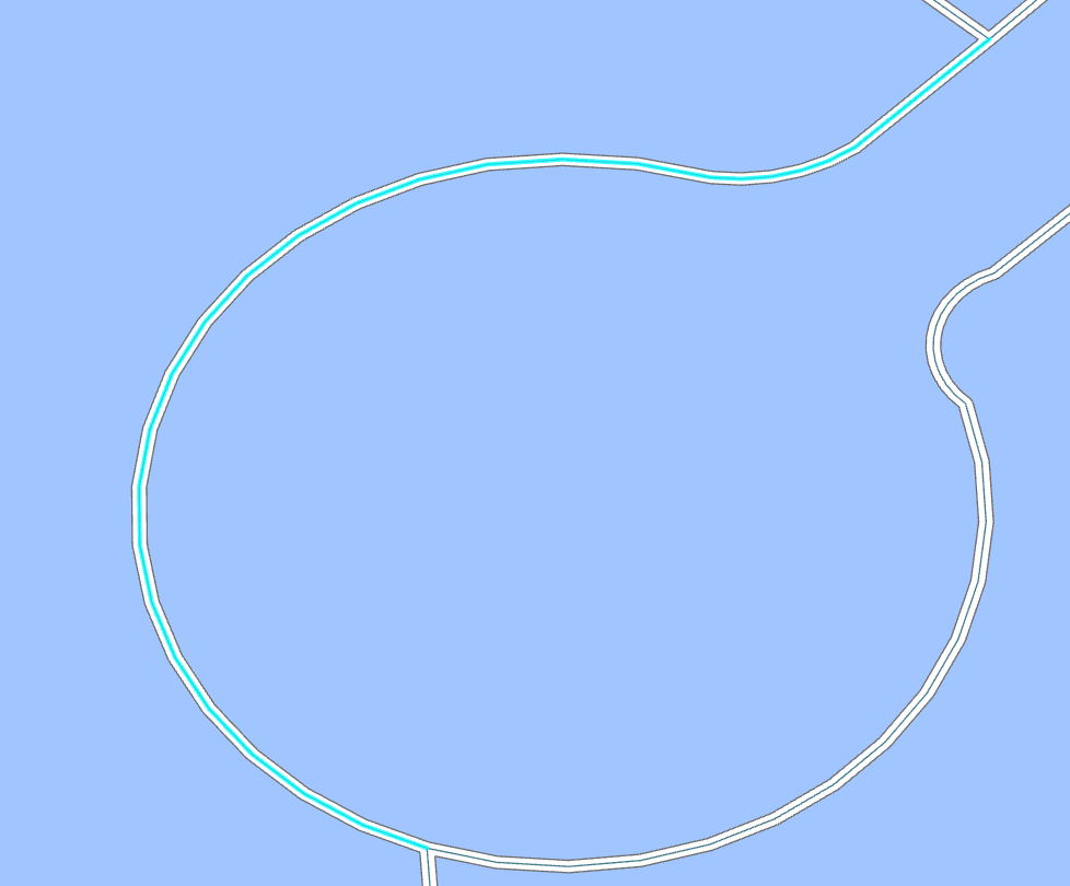

When I build polygons using the SLACA lines the output is visibly identical to the SLACA lines.  If I select one of those SLACA polygons (the bulb in the center of the picture) it looks like this relative to the negative buffer polygons:
If I run the Select by Location tool using this selected polygon to select all intersecting buffer polygons, it only selects the buffer polygon that makes up the center of the bulb and nothing else.
