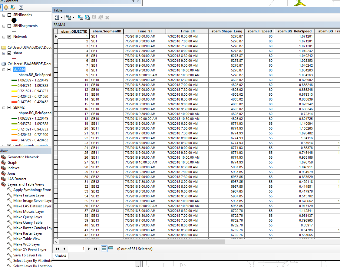

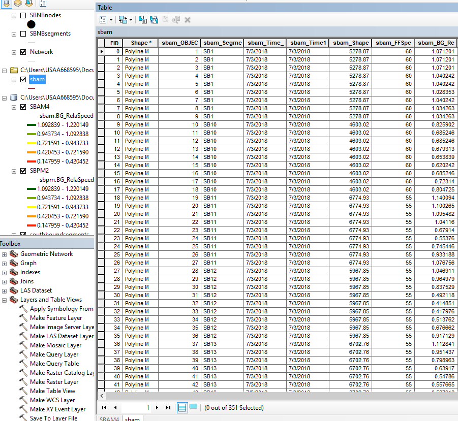

I am attempting to make a time-series in ArcGIS Online. I already have my four layers set up in ArcMap, and have successfully run time series on them all. The date fields are coded as dates and I've attached a screenshot for reference. The tables are made using Query Tables, as I have somewhere in the vicinity of 1500 records that needed matching to time stamps. Here's my problem - whenever I export the data to a shapefile, to fold it into a .zip for Online, the time stamps are shortened to just the date. Since all my data takes place on the same day, but at different times, I very much need those. Can anyone let me know what I am doing wrong? Why are my times disappearing when exporting? At first I thought it was a character # issue,  but shortening didn't help with anything.

Attribute table with all the time stamps
Attribute table after exporting

Shapefiles Date fields can only hold date information, not time. From the documentation:
However, for coverages and shapefiles, the time portion is truncated from the datetime value. For example, the datetime 2002-08-20 12:00:00 PM is stored in a coverage or shapefile as 2002-08-20.
